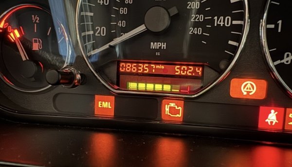

I've taken the z3 out for its first proper drive of the year, only about 35 miles on some nice roads, and the engine management light (not the EML) came on. It still seemed to be driving alright, no noticeable sounds or performance changes.

Good question, I might be confused but I have a EML light and a light that looks more like an engine. It’s the engine that is staying illuminated.

Yeah that’s the check engine light ..code reader will give you some insight. Vacuum leaks, O2 sensors etc are common

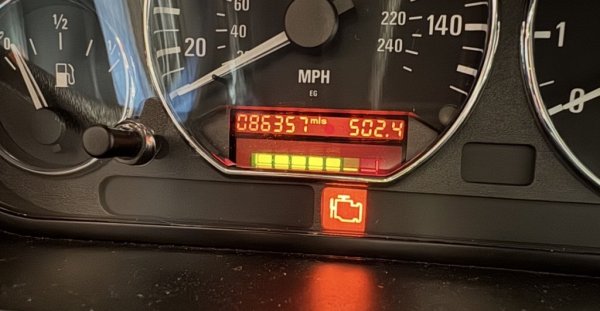

I had a few codes but cleared them. The only one that has come back is P0174 which is suggesting running too lean.
I had already ordered a Disa rebuild kit so I’ll give that a go and see if it makes any difference. It’s never been done so due either way.
Inlet hoses have already been replaced…

More likely to be a vacuum leak somewhere. Smoke test is your most reliable method to determine where…but check behind the inlet manifold, right side of the engine ..there are 3 rubber blanking bungs (or 2 and a rubber pipe connected to one)..they have a habit of rotting away.

Not got to smoke testing yet, looks like I’ll need splash out on a machine.
I did however do the disa valve refurb today which went well. The old one didn’t seem in bad condition but it’s done now. Interestingly the large o-ring between the manifold and the disa was missing so it looks like someone has been there previously. Refitted and codes cleared but the check engine light came back on during the test run.
