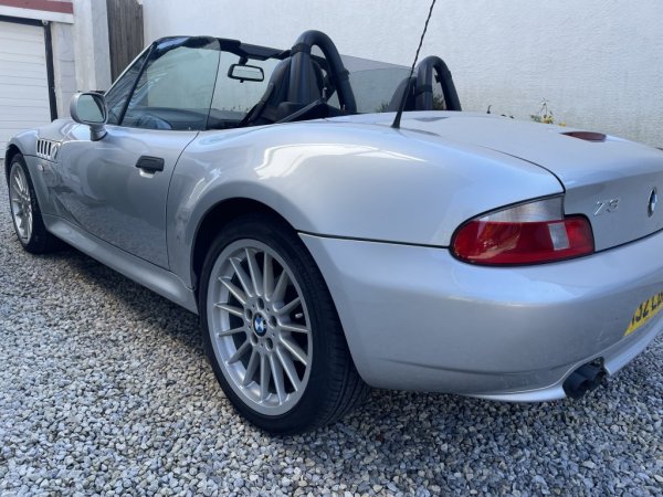

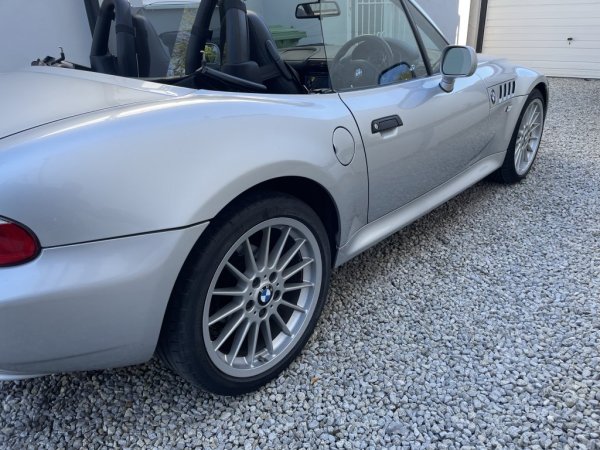

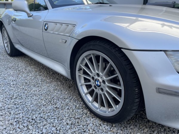

Wheels arrived earlier this week - had the chance to fit them after work.
Thankfully, they don't look too big (in my opinion) - think the lowering and smaller tyre profiles help with that.
I went with ET35 in the end as I was advised 42 may not be the best fit - turned out to be very good advice, although I added 15mm spacers on the rears.
